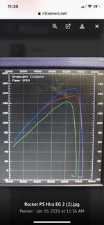

Well here is my confusion on those numbers; if you look a the dyno report picture that Penner put up, with the standard map the rwhp is about 145, and with Penner's map the rwhp is 170. The usual HP number quoted by Triumph is 165 BHP (presumably at the crank) so it loses 20 HP from there to the rear wheel. That should mean that with the revised mapping there is 190 HP at least at the crank, however Penner indicated it is only 185.
I believe Triumph quote 165 in their materials. Penner is showing 170 at the wheel and he also has a driveline loss calculator with the actual dyno he’s using so he doesn’t use the Triumph loss number he uses the actual number his dyno calculated. He clarified this to me. When the drum in the dyno is rolling down after a run it calculates the loss actually present in that bike at that time in that place, so there are variables to explain the drive loss discrepancy in his final calculation and Triumph’s. I had a very accurate and calibrated Dyno done in my bike and I too got 171 to the rear wheel. I have DNK tune and Comp Werks pipe. Every bike and dyno is going to be different. If you want to know what your bike really makes you gotta go to a good dyno (find a dyno that uses the Eddy Current method) and they will know exactly what the bike makes at the wheel which is really the only number that matters.
