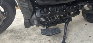

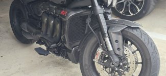

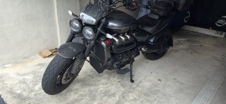

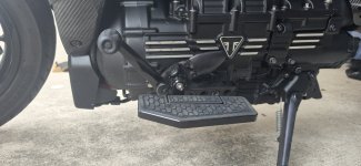

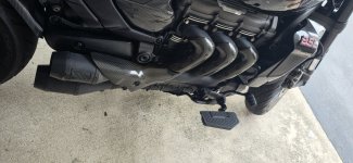

Used about $200 to buy Chinese floorboards to get parts from to get this setup.

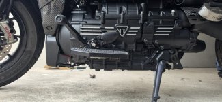

Notice how the floorboards have 2 ways to "collapse". First is the retained original movement in the arm. Second, the choice of floorboards that have their own hinge too. So, 2 safe ways to give in when turning hard.

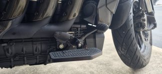

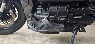

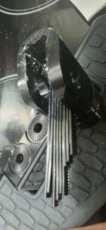

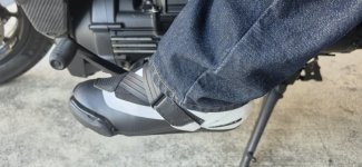

Before my biggest hurdle was how to lower the floorboards, as without any sort of lowering the boot would not safely fit under the speed selecting lever.
I know I used a wrong shoe type for the pic, the only one I had handy at the time of taking pics. But as you can see, the clearance seems to be good enough (pictured shoe is US size 11).

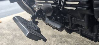

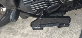

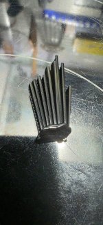

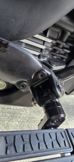

Installation:
Had to make these changes:
1) As I said originally, the connector (one that goes in where your original pegs connected to the bike) is 99% like you need. I had to shave about 1mm, maybe 0.9mm. I used a belt sander, about 5mins each. You can get away with a file. Main thing, don't take off more than needed, so, check for fitment often. It is utmost important to take off minimal amount. Don't take from both sides, take only from the bottom facing side, keep the top one good looking and untouched. Also, even then you might think it barely fits but still a lot of play, once you'll add the spring, that slop you feel will go away.
2) Change out to my own 30mm long, 8mm wide bolt, add compression ring, flat washer, and a metal nut with a nylon lock ring. So, the proper order, 8mm bolt head (30mm long), 8mm compression ring, floorboards, the extension, the 8mm washer (wide), the 8mm nut with a nylon locking ring. See pic. This is a must in my opinion to keep the floorboards well put together. Another top bolt that goes through the extension into the connector, I put on orange thread locker, let it cure overnight.

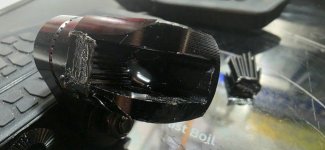

3) Noticed the middle groove is longer than on the original pegs about 5mm deeper. Issue is when you try to install, the round spring can't find "backing" and doesn't work. Not to overthink, I cut 5mm zip ties, added them back to back, glued on hot glue, then used a hot knife to take off the top. It is not a load bearing part, so, worked out well enough and very quick. But you do you.
Overall, the whole modification for all 2 floorboards took about an hour.

Nicely done and great writeup. I'm tempted to give it a try. Have my Ducati for canyon carving, so I don't really scrape any pegs with the Rocket. Have to admit I like Floor boards on the Harleys I've ridden.
Question: Why didn't you just bolt the lowering bracket directly to the rubber floorboards? With the hinge already on the board, wouldn't that work? Skip the second set of boards entirely?
Can you be more specific? The lowering bracket is bolted directly to the floorboards.
