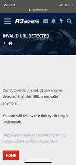

Ooooh look at them knock off copied race rech emulators just playin whatever they work and change the forks 10 fold over new springs alone
Tighten up on your links will ya how we suppose to buy good stuff
