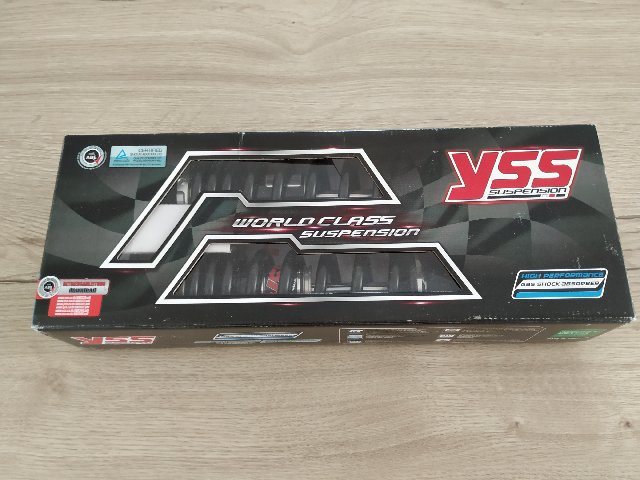

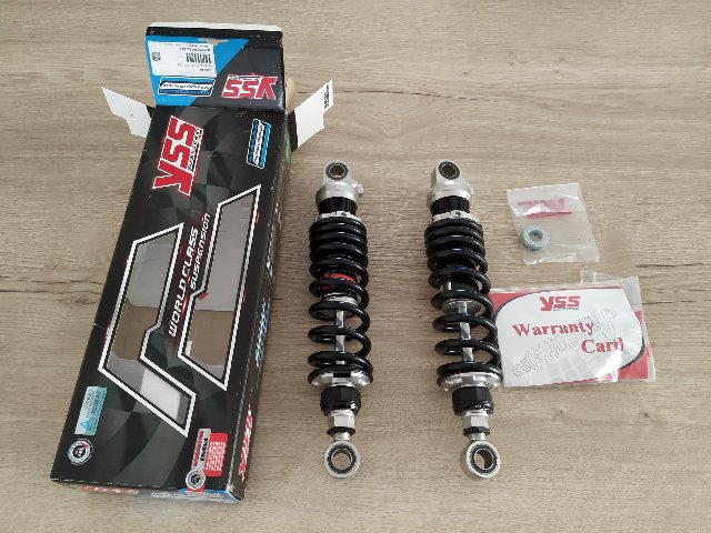

Today the YSS rear shock has arrived
Anybody got the best place/price for these lately? Best I've still been able to find is still from WRS in italy. (originally linked by an old post by @Journeyman28778 . The price has gone down a little since then (not too much). Looks like @ $365 shipped to the US before any possible "make offer" reduction.
I keep putting off doing anything with the suspension just because It's not something I've really gotten into with all the setup involved to get the most out of any upgrade(s). I do know that when I put Progressive springs in the forks of the old Honda Magna it made it ride like a completely different animal though.
I'm a big guy at 6' and around 275 lbs. so I definitely need some suspension upgrade(s) over stock. I generally ride 1 up 98% of the time, but I do have some tsukaya hard bags that I keep some small stuff in on a regular basis. thinking about these for the rear and Progressive springs for the front eventually. Any help on proper setting up of the shocks would be much appreciated as I know we have some suspension guys on here...
