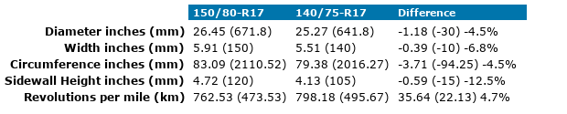

So stock front tire is 150/80 how a 140 how much smaller is that? is it noticeable? but improves corning even better?
what does it look like is it noticeable against a stock Rocket? or not that noticeable? does it look nicer?

I did the 140 change and I love it. Quicker steering feel, lighter on slower turns. Looks not much of a difference but there is bit more light between the fender and tire. The space or void doesn't bother me a bit compared to the handling change. I love it.

150/80-R17 vs 140/75-R17 Tire Comparison - Tire Size Calculator | Tacoma World
Ishrub, looks like if I go for the smaller tire for even better handling I can think I going faster but not get the speeding ticket because I'm actually going slower cool:)
Well not the front one. Coincidently by fitting the E-Max rear you have done the opposite. You are going faster than the ECU thinks. But as it was optimistic (unless corrected) it has simply made it closer to reality. You will however be apparently getting less mpg.
So fitting a smaller tire on the front my Rocket is slower and I'm not getting as good gas mileage just to go around a corner a little better Humm my orange rocket is fast should I SLOW her down more by putting a smaller tire on.
