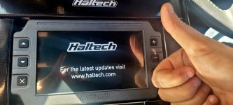

Also, this arrived. Bigger than I thought and heavier as well due to the metal housing.
