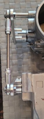

Actuator hardware arrived today. Quality stuff, especially for the price, bracket should be here early next week for the final assembly / validation of fitment of the eThrottle assembly conversion. Will need two washers per heim and longer screws, but otherwise, it seems like all the right stuff.
All in all, I think this will work out really well.
For final positioning, I'll have to wait until it's on an engine and in a frame to see if I can move the arms inboard after shortening them, so they are more protected.

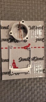

Things have arrived, early even.
Send cut send is absolutely over the top on professionalism. Not a hobbiest feel at all, straight big business feel, very impressed (plus sour patch kids packet in the box, a sure way to win me over).
Tolerances were phenomenal, deburring was great, not a scratch/mark on the aluminum anywhere.
So, this is why we prototype before installing...
Will I run it like this, yes, will I order a revised bracket design to make sure it fits perfectly before posting publicly, also yes.
There turns out to be a significant disagreement on what takes space between the oil tank and the actuator with this configuration.
There are many ways to settle the dispute, I've been mulling over which solutio to use and I think I've decided to flip the actuator so it sits ahead of the TB assembly and use two gears to invert the motion direction. Still need to devise a bracket, this will be more involved than the last bracket.
