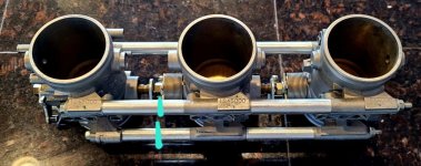

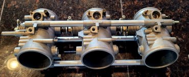

I couldn't leave it alone...
Pulled my 55mm throttle bodies apart to evaluate what needs done for DBW actuator fitment.
On the cable end, there are already 2 pivot locations. One male, one eyelet, that can be easily adapted for connection to the DBW lever arm using a heim or rose joint.
So, at this point I'll be ordering the DBW actuator soon so I can mock up a test mount, validate, and then have one jet cut from aluminum. I have concerns about the bolts that hold the TBs together bearing the force, they're only 8mm diameter.
If it works out, I'll pull the 58mm set apart and fit it all up. Primary TPS will be the stock unit, backup TPS will come from the actuator.
Frame got degrimed today and will chop it tomorrow to haul to powder coater.
If my measurements are correct, this will be an extremely simple adaptation to mount the ATP actuator using a fairly light weight bracket.
The ATP actuator is 43.5mm thick. From red to yellow is 45mm, so a 2mm thick bracket will position the actuator and lever arm very nearly in in parallel. A .5mm thick brass washer will even it and serve as a bearing surface for the heim ball to avoid steel on steel.
I may use a 2nd bracket to support the actuator motor that extends out and relieve the two 8mm bolts of the bending stress of a cantilevered motor.
Close tolerance slip on over teal lines and a 2 part clamp around orange will provide a strong support that will alleviate stress on the 8mm bolts. The silver rails are supported by collars in the TBs and not just the 8mm bolt.
