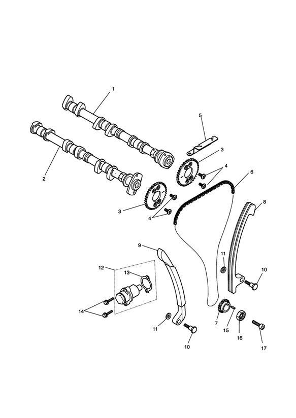

Where did you get your chain @sonny, Hermys?
OEM Triumph Genuine Motorcycle Parts | HERMYS TRIUMPH eSTORE
Camshaft & Camshaft Drive. For 2011 Triumph Rocket III CLASSIC & ROADSTER | HERMYS TRIUMPH eSTORE
There appears to be two choices T1143200 and T1143210, depending on last 6 digits of VIN rather than Engine number as they state I think.
A bit odd that the later models do not come with the sprockets while the earlier version did.
Can @warp9.9 or the educated advise?
I found a UK eBay site that sells the chains but they appear to be identical.
Price: GBP 76.99
Approximately AU $141.56, US $100.64
+ shipping GBP 26.95 (approx. AU $49.55, US $35.23)
Cam Chain Triumph Rocket III Roadster 2294cc ABS 2010 to 2012 | eBay and
Cam Chain Triumph Rocket III 2294cc 2004 to 2009 | eBay
Hermys info:
2011 Triumph Rocket III CLASSIC & ROADSTER Chain, Camdrive, 170 Links. Eng No 362330 >. Engine, Camshaft - T1143200 | HERMYS TRIUMPH eSTORE, Port Clinton PA
6 Chain, Camdrive, 170 Links T1143200 Eng No = or Greater than 362330 > $114.71
Kit, Camchain & Sprockets T1143210 > Eng No up to 362329 $194.92
