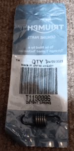

I received my new 2nd gear shift fork (C) and compared to my original to find that the original was bent as well as having the wear on the side facing 2nd gear.
I also got my new detent spring and found that it is somewhat different than my original one. It is made out of the same stock (wire diameter) but is a little shorter and has 5 turns instead of 6. Original length is 32.45mm, new one is 30.6mm. Anyone else notice a spring change?
