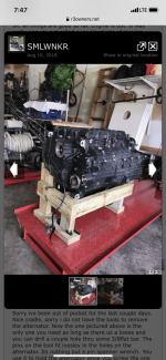

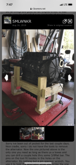

If you have some neat way to turn the frame over with the engine in the frame, good on ya. Otherwise, take the time and remove the engine and flip it over on a homemade saddle/cradle. Once you get the two halves apart, the crankshaft and balance shaft can stay put and it goes back together so much easier.
