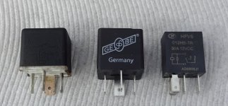

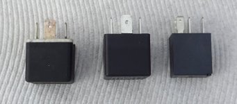

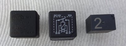

Pictures of relays. From l to R. Original T2506040. GEBE 993001. Triumph replacement part for original T2507727

Triumph changed over from the squarey ones to the smaller rectangulary ones around March 2013.
The original leftmost one has a diode on the switching line whereas the middle one doesn't
First, got hold of a used one, fan works. QUESTIONS: I'm not an electrician, so correct me where I am wrong here. The original 4 pin (manufactured by Hella) had a diode that restricts the current to one direction, that protected the ECU? The GEBE has a resistor to protect the ECU, BUT, a diode protected relay is better? The only 4 pin 12V 30A relays with a diode I have seen have a replaceable 30A fuse? The updated Triumph relay has a different pin configuration than the original?
Thank you everybody.
Yeah you got it. The non diode will work OK for now but I'd always recommend replacing like for like.
Strangely the new Triumph relay (smaller one) doesn't look like it has a diode...
The new Triumph relay (smaller, more rectangular one) is a micro relay, Triumph started using them in the Rockets in March 2013 AFAIK, but it's not a replacement for your original one. They should still supply the older relays for the older bikes.
04 to 13 bikes have relay sockets for the big square ones and 13 onward have the smaller sockets for micro relays.
