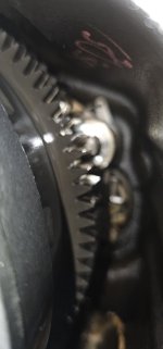

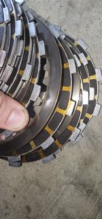

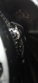

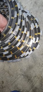

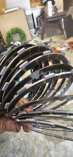

I bought this bike back in May and have put almost 5000 miles on it and when I changed the oil I put high milage car oil in it about 2k miles ago I've changed the oil with mobile 1 racing 4t multiple times since then and my oil is still turning grey. When the barnett clutch was put in there were some issues with adjustment. Which made it so the clutch was never fully engaged or disengaged. That was sorted out but the clutch started slipping again and it's kicking me out of 4th gear. It doesn't matter if I downshift into 4th or upshift. If I go on the throttle even a little while in 4th it will kick me into 3rd or a false neutral. Here are pictures of my detent spring and my friction plates. From what I can tell the detent spring isn't broken but I haven't taken the basket out to check. Any advice would be appreciated.

He said the oil continues to have grey "stuff" in it- I'm thinking it's the clutch pads.
He said the pads look brown (not grey)- lighter brown in the front and dark brown in the middle. Maybe burnt? They look grey to me in the photos though.
He said when he pokes the detent spring there is some movement on one end- is that normal?

I do not believe the detent spring will move. The pads and steels are shot, high mileage car oil probably had friction modifiers in it and the pad material dissengrates. Keep using motorcycle oil, get a new clutch pack, probably gonna have to get in there for that detent spring, and set clutch up correctly and it will be golden, my best guess from afar
