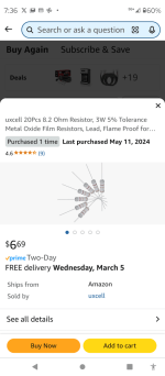

Here is the resistors I bought on Amazon.
