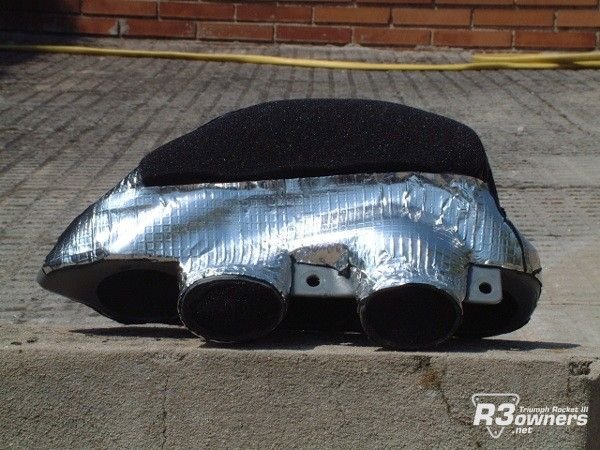

Poor Man's Performance
If you want it low cost, you don´t need KNs or Ramair.
Just open the airbox in the area above the throttle bodys and close it with filter foam.
Can be done.
BUT you need to get the Air Temp Sensor into the airflow and this is hard to do well on the outer plenum.
This solution will also benefit HUGELY from the Oz-Claw. It's almost impossible to add a heat wall to block undertank to plenum airflow too.
