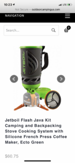

I’m making due and can boil water again now that I got my new propane stove.
I also learned that there is a small grill that you can attach to the MrHeater propane heater that you can heat up water and food so I may try to find some wire and make one.

A must have item.
