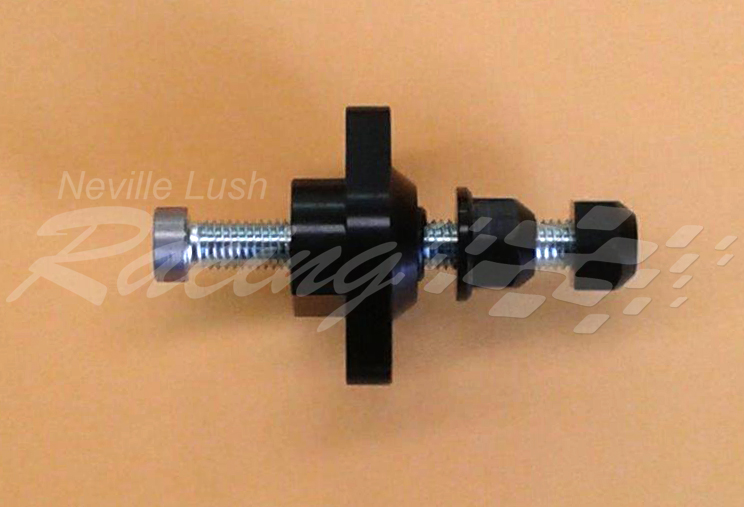

@warp9.9
I'm pretty sure I've got a handle on how everything is supposed to go together & function. But, clarity is a good thing, so if you would; please tell me if I'm right or have something out of place.
Using your pic below.
The slug is going drop into the hole in the plunger (past the interior measured surface) and the spring goes into the hole too, resting on the slug.
To ensure there isn't already a slug installed you need to look for the tooling mark at the depth of the plunger. Seen only partially (the half moon) in the pic below?
Link Removed
