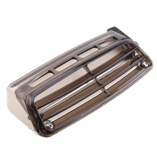

The vents can be bought off eBay from China for Au$47 (about £24.23 for you without 10% GST) free shipping and can be installed in any screen.
