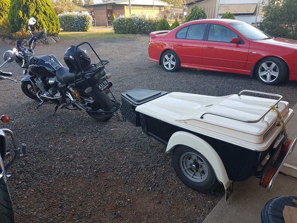

I got the classic trailers hitch have them on 3 of my bikes, towed a classic ultra light trailer behind my XJR1300 Yamaha and had to keep looking to see if it was there, just give yaself time to pull up and don't cut corners the rocket will do it easy!!!! I haven't tried the rocket yet as it is still off the road.
Looks small and neat
