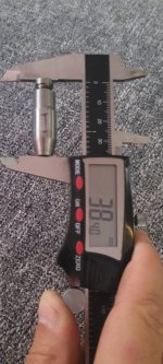

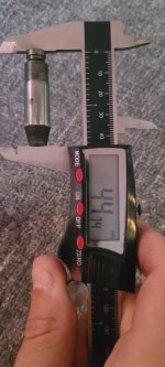

Step 1: source Manganese Bronze replacement valve guides. Got these today from the machine shop so I can source the correct replacements:

Why the different lengths of the guides, I assumed the guides would be same lengths, and are you thinking of shortening the length of the stroke, changing the rod angle and maybe a few mor rpm's?

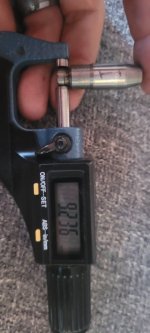

Since I couldn't find this info anywhere on the net:
Triumph Rocket 3 Valve Guides
I'd imagine the guide length disparity is due to port angle, the exhaust is a much shallower port angle so sits lower in the head.
Trying to get under 26 m/s mean piston speed at 9k and you nailed the other main benefit, a little less angle. Spool won't be an issue (in fact I'll have to delay it with WG solenoid) so extra length is in no way beneficial to a turbo rocket.
Thanks for the explanation, I just assumed the lengths of the guides would be the same. You know what they say about "assume". I didn't realize you were possibly going turbo. A lot more opportunities for power, but also some pitfalls. As always, want you to succeed.

Bit of bad news -
KPMI, Supertech, Ferrea: none list a matching guide for either size.
Bit of good news -
KPMI makes guides with the correct sizes in all locations so just not all at once, meaning it shouldn't be an issue to have a set cut from Manganese Bronze.
With that I'll be shipping a set of valves, keepers, retainers, springs, and guides out to Ferrea on Monday so John can get accurate dimensions. Then he and I can discuss getting modified versions made.
Looking to swap to shimless buckets from Toyota 1zz using 1.6mm longer 39mm Stainless Intakes/34mm Inconel Exhaust valves, getting the seat above the interference fit but below the seal on the guides shortened by 2mm, and a shoulder added as a positive stop, then some 12lb/mm double springs made with matching tool steel retainers.
The idea is, the shorter guides will create space for a 12.7mm+ lift cam, the longer valves will allow for shimless buckets without sinking the valves in the head, and the last bit is the seats. I'm fairly certain an off the shelf 1.575OD beryllium copper seat will work but waiting depth of the stockers from my machinist to confirm.
