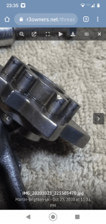

Is it just the camera angle or my eyesite but does that hole at the bottom of the shifter fork look oval?? If so, would that cause the fork to wobble on the shaft which would prevent complete engagement of the gears/dogs and the wear seen on the fork portion. What does that shaft for the selector forks look like? Can you wobble the forks on it? (PS, I've never heard of anyone having a problem in this area before???)
The detent wheel itself has a worn notch in it which I could feel when checking for sharp or damaged surface
