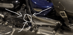

Howdy, i know second gear seems to be a big issue with some rockets, i'm having trouble with first gear, put it into gear and its like it goes only half in when try to take off it just pops out and you put it in first again it catches, i was told to take out and clean the unit in the picture (Not my bike), anyone else experience this or able to point me in the right direction?

That's the gear position sensor. Not sure how cleaning that will help 1st gear engage better mechanically....
