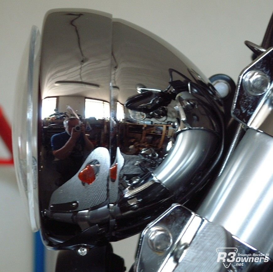

The ONLY potential issue I can think of is the rear width. The early 8630 would NOT fit directly in the R3 headlight Buckets without
1) Moving the bucket mounting brackets to the outside of the shell
2) Modifying a set of "Frenching Rings".
I did Option 2.
full
But the 8630 was not expected to be fitted into bikes. And J.W.Speaker have come a LONG way since then.
