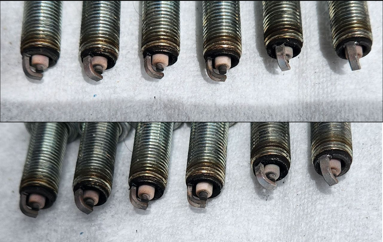

Below are my Stock spark plugs which were running
Penner tune running for last 10000km or 6000mikes
+ Werkes Exhaust for 8000km or 5000mikes
+ Deleted/uninstalled o2 sensor for last 1000miles
+ DNA air filter running for last 1500miles
Exactly. Penners tune + O2 disabled holds it in a good range of fueling.
Stock tune + O2 enabled will be notably leaner than this, strap line and fire ring on porcelain will be shift further due to being hot all the time.
A lot of canned tunes will work with various hardware since they're on the rich side of 14:1, so a little more air here and there are closer to ideal than the stock tune is.
Remember, Mama T is targeting Euro5 and Euro5+ standards, not power, not response, not mileage.
How about stock air, stock tune and Vandemon pipes? It might be a month or so before I get a tune. Should I delete the o2 sensor and do the 12 minute idle?
just my opinion
when you do the 12 minute tune it will do nothing with out the 02 sensor working
