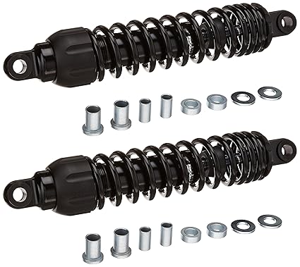

What was your preferred preload setting? I just got a new set of 444 and don't know how to set them other than by the butt-feel method.
Push down on the seat and let it come up to rest position slowly, but on it's own. Then measure between the centerline of the mounting bolts.
Adjust up or down on both sides, then repeat
You want the mfr specified length to be 1" longer than the mounted static length. If you bought 12.5" shocks, you are looking for that measurement to be 11.5" From there we can increase or decrease based on your feel

That accounts for the weight of the bike. I guess the rider's weight and riding style will lead to any change from there. Looks like very little preload change goes a long way and butt-feel is important. How about which sleeve to insert in the bushing? How do you choose that?

If you gave them your weight when you ordered, they will have installed the correct progressive springs to account for sag with rider.
Not sure what bushings you are talking about. It was almost 2 years ago when I installed mine and don't remember. Text me pics
But they should just slide on in place of the old

Sh!T sorry, just double checked. You need to be on the bike in full gear with your luggage mounted as well. You'll need the little lady to measure for you while you are on the bike. A floor chock will help immensely so you can stay stable as you won't have your feet down
And if you mean these bushings... Find the one that you can slide over the post and is not longer than the post itself.
