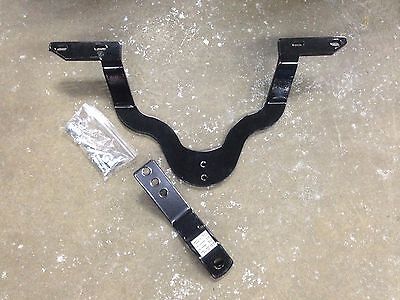

Trekker TH-004
The eBay seller TrailerETC is actually the maker of these for Trekker according to Trekkers website.
Trailer Etc
Description
2008-UP Triumph Rocket III Touring Trailer Tow Hitch
2008-UP
This kit includes: Black powder coated receiver, and *bolted* ball holder (tongue) to prevent noise and all necessary hardware (bolts, nuts, bushings). Chrome ball holder (tongue) is optional for 29.95$ USD.
Does not include ball.
This hitch is manufactured by Trailer ETC… And is specially designed for your 2008 –UP Triumph Rocket III Touring
Tongue weight rated at 40 lbs.
Tow weight rated at 400 lbs.
Steel construction for maximum strength.
All non-visible components are black powder-coated for maximum rust proofing.
Kit includes necessary mounting hardware.
There are 2 holes for the security chains or steel cables. (Chains or Cables Sold separately)
Free Shipping to Canada or USA (Lower 48), Except Hawaii, Puerto Rico and Alaska.

US$299 new apparently:
2008-UP Triumph Rocket III Touring Trailer Tow Hitch – Trailer Etc…
Certainly looks neat fitted.
