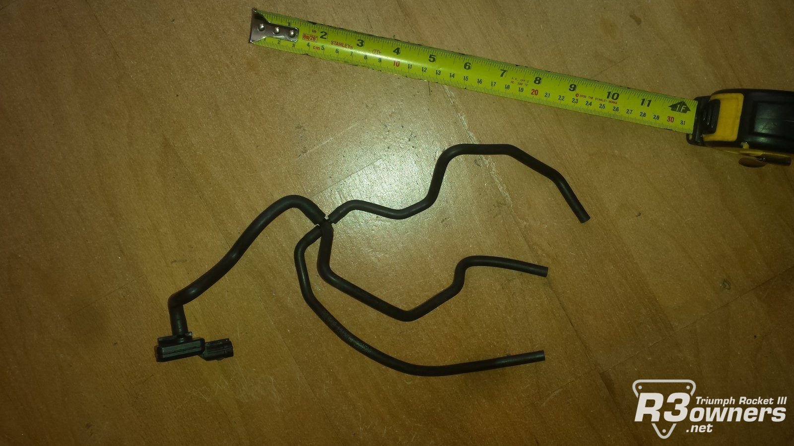

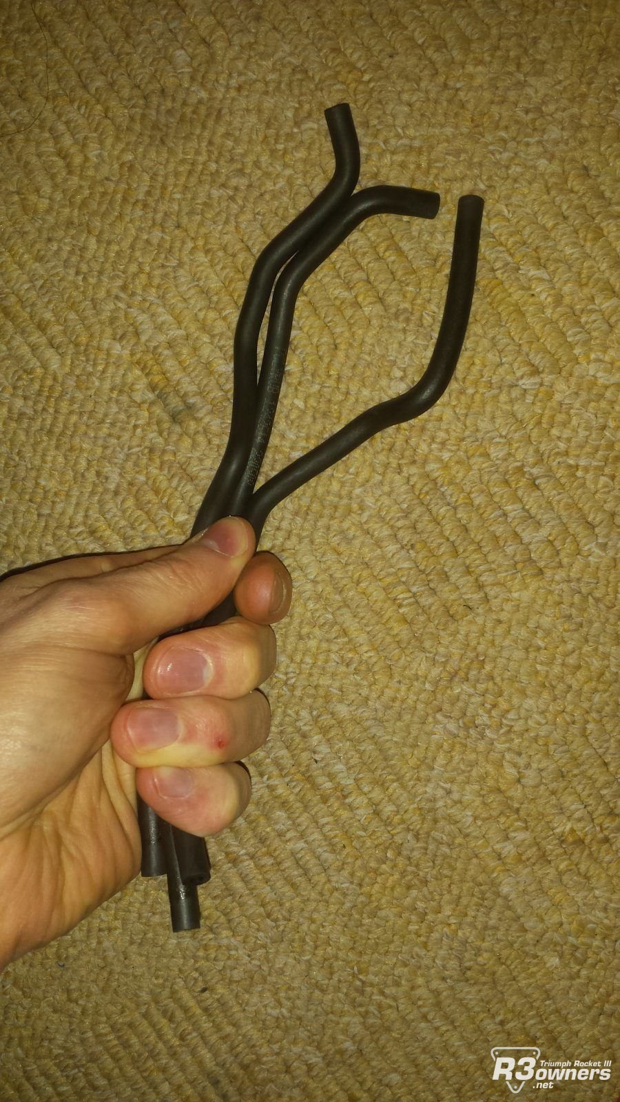

What was on before the RAMAIR? - RamAir AIT extension wires connected properly?, MAP sensor hoses kinked or mixed up? - the hoses are different lengths and the ECU knows this.so something had to happen during the time everything was removed for pulling the valve cover or swapping out to the RamAir.
