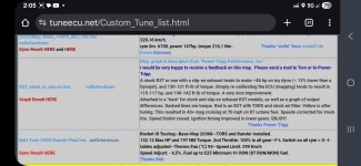

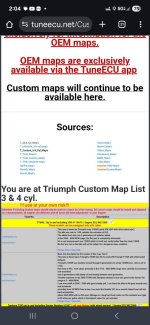

Is this the Nels tune from Bob R your talking about, cause I think that's what I have loaded 20368?
