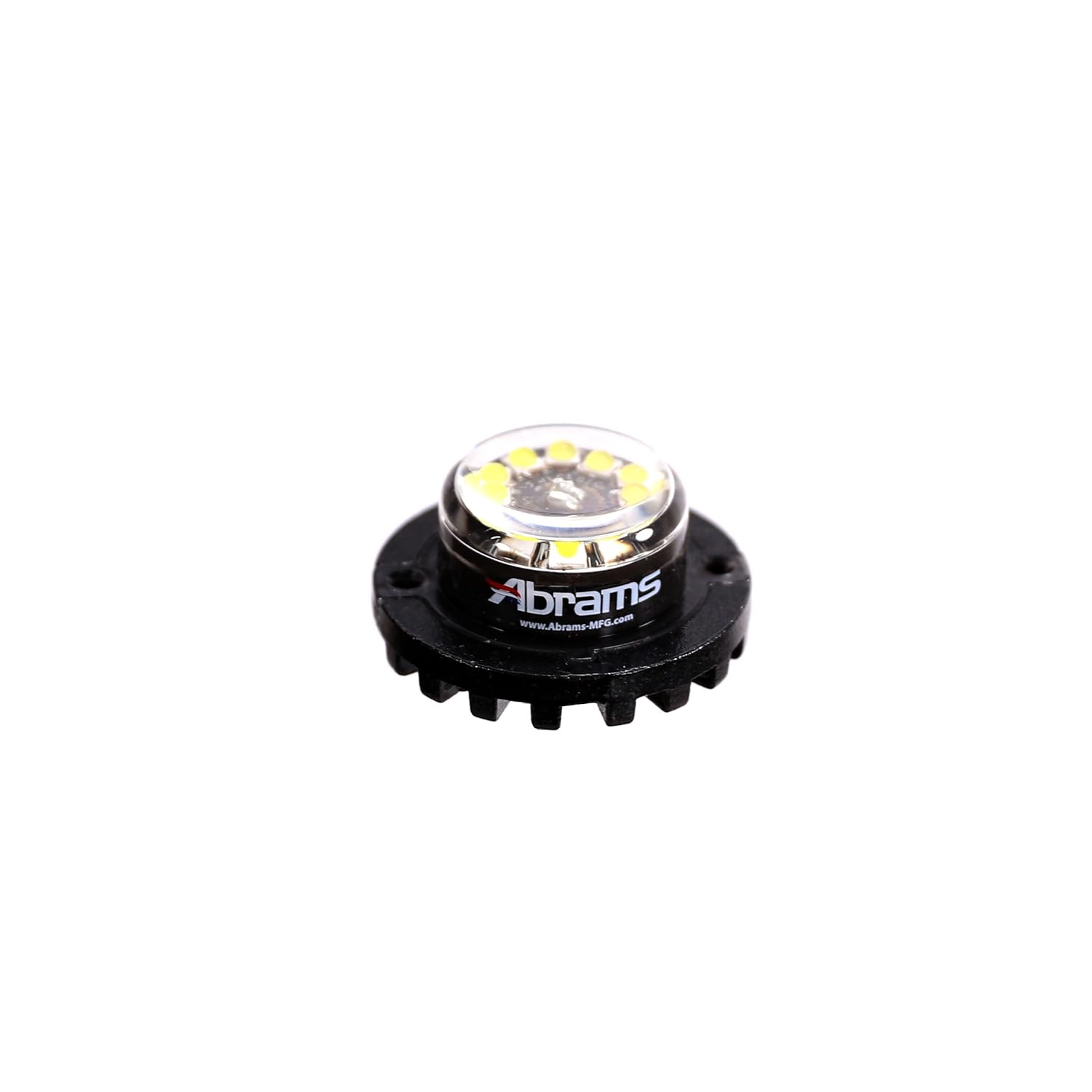

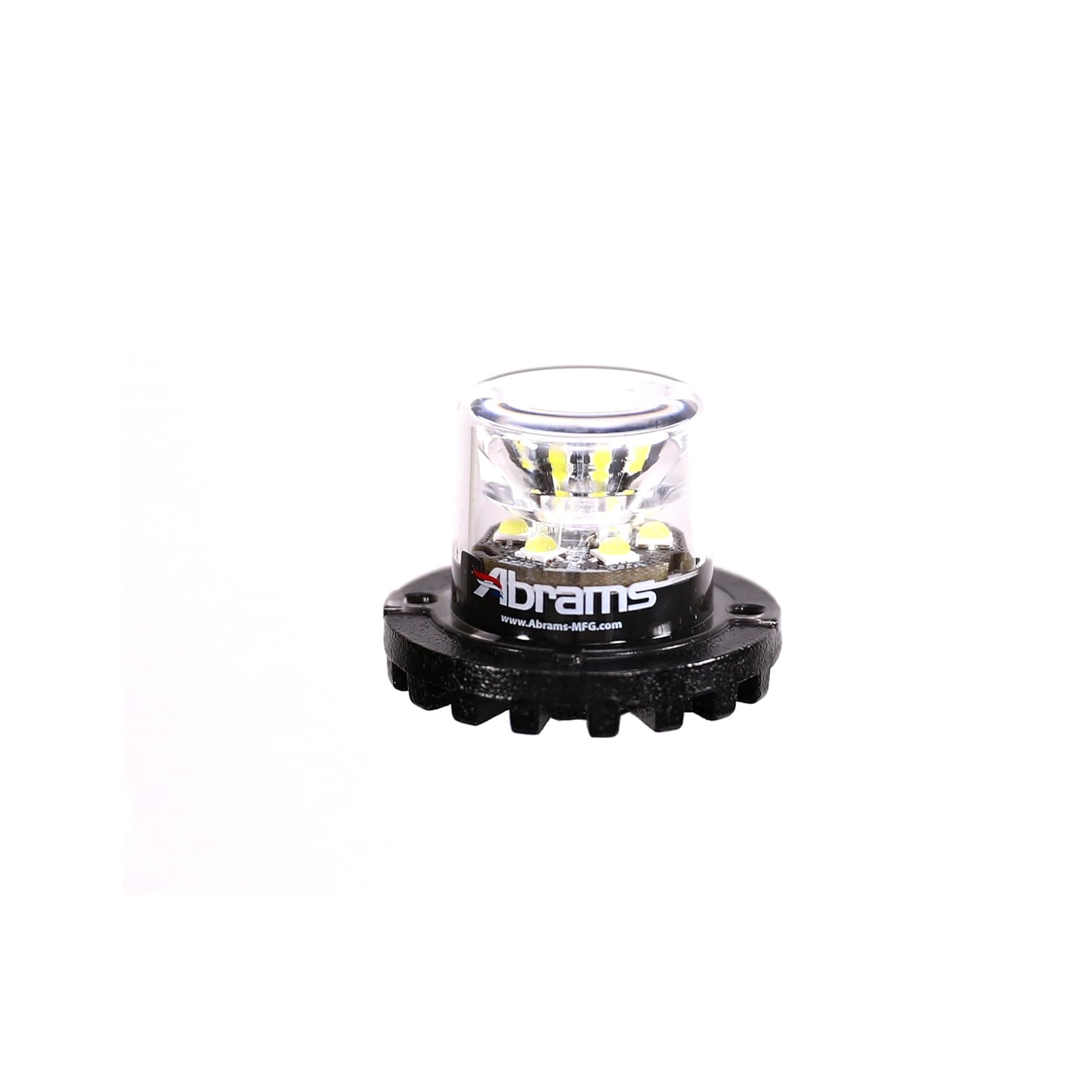

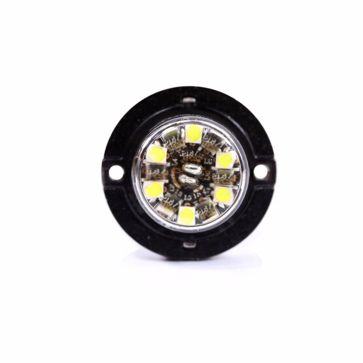

All your dreams for side and rear appearance of your indicators to observers and you can read the specs to your hearts content in the instruction guides.
https://images-na.ssl-images-amazon.com/images/I/B1sk2M7PRaS.pdf
Abrams SAE Class-1 Blaster 360 (Amber/Amber) 18W - 6 LED Tow Truck Construction Vehicle LED Hideaway Surface Mount Strobe Warning Light
Abrams SAE Class-1 Blaster 120 (Blue/Blue) 36W - 12 LED Police & EMS Vehicle Truck LED Hideaway Surface Mount Strobe Warning Light
Abrams SAE Class-1 Impact 6 (Blue/Blue) 18W - 6 LED Police & EMS Vehicle Truck LED Hideaway Surface Mount Strobe Warning Light
https://images-na.ssl-images-amazon.com/images/I/81-linXfqlL.pdf
Abrams Blaster Emergency Vehicle LED Hideaway / Surface Mount Strobe Warning Light -
