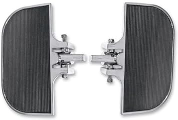

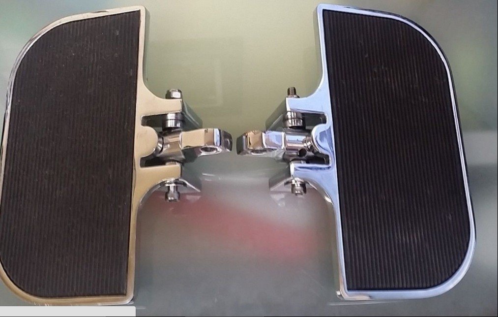

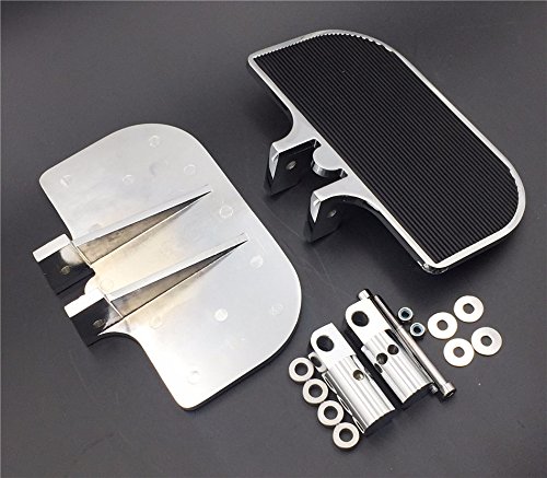

These Emgo - 54-48054 - Mini Floorboards for US$50 may be worth checking out for the price alone and seeing if you can adapt to fit.
Even better US$37 from Amazon
Product Description
  • Die-cast construction with chrome-plating and non-slip rubber matting
  • Replace male clevis mount footpegs; supplementary mounting holes allow floorboards to rotate 15 degrees for the perfect riding position
  • Measure 4in. x 8in.
  • Sold in pairs
    More cheap options with a little fettling.
    $43.99 & FREE Shipping
