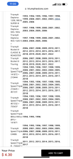

It's only a 10nm fastener by the manual but the dimensions are...not off the shelf friendly to piecing together a replacement.
All these also use same
Also shows unavailable on the cross-reference bikes I checked. Triumph giving the middle finger to a lot of folks on this.
ProBolt has no interest in making it, but they make the smaller version for other Triumphs.
I'm not paying the stupid prices people want to make 9 of them.

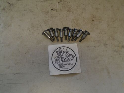

So that leaves, in order:
M6x40mm Ti GR2 button head full threaded
M10x19x3 Washer
OEM double seal
M6x25x10 threaded collar
In order they should fully seal with a touch of RTV placed in the collar while assembling and not more cheesewiz bolts.
I'm pretty sure the cam cover bolts for my America and early Speedmaster were the same. Used the same seals if I remember correctly.
Yeah, there are many Triumph applications, all unavailable.
The voice to use a 23mm lock collar of 10.75mm diameter and 37mm length under the head with 14mm of thread is just all kind of awkward for finding a replacement.t
