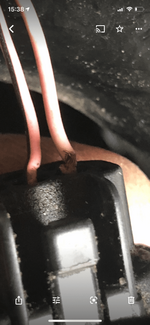

So in leakey i battled the widowmaker, i won no blood, but i had a tps issue, @Rocket Scientist generously dug in and i was glad, we noticed a wire on the map sensor plug had wire showing, but we moved on, well i got a few hours and got after that plug, walleye tps good, now to change the springs i neglected to change when i put this engine back together, moving on. Then in about a month we roll out The Lush Racing grudge eating street machine.
