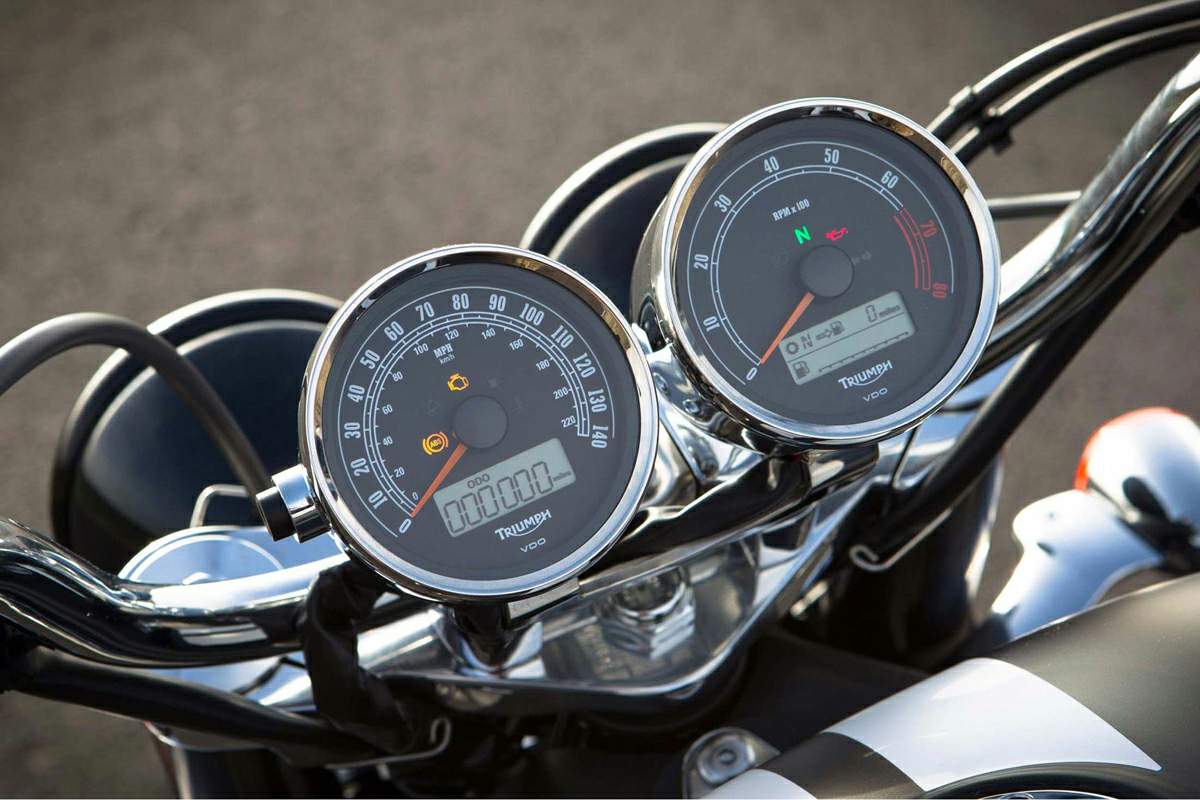

So how did it go with the later black face speedo replacing the original two tone face version. These are both pre ABS but the two tone early version had a different connector plug but could be wired to the later black face pre ABS unit in use up to the Rocket Roadetr witrh ABS came out.
This is relevant to @phar2slo who is chasing an early two tone for a mate in NZ.
I have Kmh only spares of the later black face Rocket III pre ABS instruments (used), and later Rocket III Roadster ABS (new); and both mph R3Touring pre ABS 2008-2012 and ABS 2013 o ones too. One R3T is new, one used.
Two tone
Black face
Roadster ABS
Everything went well, the speedo works perfectly.
