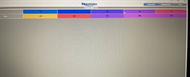

What rpm is the idle set to on the new tune?

I included a picture of idle in the tune. At cold start it actually settles down to around 800-900 quickly. Before it gets up to temperature. I might try to unplug the stepper and see what happens.
Another thing is O2 sensor is taken out in the new tune. I’ve not seen any issues with that from other users but maybe.
