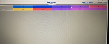

Here’s a picture of the throttle table on the new tune. I will have to look and see what it is in the old tune.

What i was talking about was forget the spacing and go with the tps settings with tuneecu retract stepper motor set tps at .062 then engage stepper and tps should be at .074 if not adjust the stepper mortor.
This should work as long as nobody has been messing with the idle stop.
