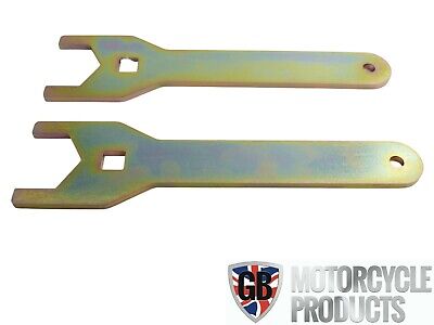

I'm confused. The catalog number for that wrench shows 1-1/2", so what did you modify ?
A true hair's width! So are the bearing adjustment and lock nuts same as the top head stem nut?
38 mm is 1.496", 1.5" is 38.1mm.
3880140-T0301 Head race adjusters

Factory tools may assists - price seems reasonable and plenty in stock.
Triumph 38mm Steering Stem Tool Set
Part No. 3880140-T0301
This is a set of 2 spanners used for adjusting the Head Stock Bearings.
The tools are zinc plated to ensure they last for years.
Price: GBP 18.00
Approximately US $21.94
Shipping: GBP 12.00 (approx. US $14.63)
Aussies pay GST and extra postage :( :thumbsdown:
Price: GBP 19.80
Approximately AU $36.99
Postage: GBP 13.20 (approx. AU $24.66)
