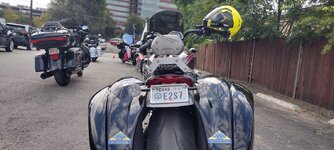

I have an Innovv K3 (which has 2 small cameras instead of that big honking K5 front camera).
Front camera is mounted under the headlights. Cable routed up under the tank. DVR is under the seat.
The rear camera has been 3 different places.
I had a Triumph luggage rack, until the rails snapped, and the camera was mounted under that.
While my new flag mount was being fabricated, I mounted the camera on the fender just behind the seat with double stick tape. (Photo was taken when adjustments were being made to the flag mount. It looks like the camera is mounted to the sissy bar, but it is attached to the fender.
The black square to the right is the GPS antenna for the K3.
The new flag mount is done, and now the camera is mounted beneath that.

Great info- thanks!
