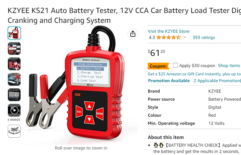

Do you guys have battery tester? perhaps your battery is going bad? I bought something like this for car a year ago and helps me everywhere!
