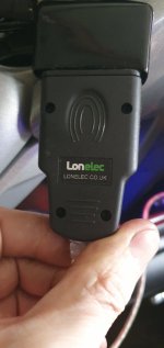

Sorry to ask which tuine ecu lead do I need as I tried this one and won't conect to my 23 plat rocket
You need a Bluetooth module to remap. See the basic guide on Tuneecu.fr. In the bikes list, touch your model and a pop up tells you what to use.
OBDLink LX/MX, UCSI-2100 or vLinker MC
