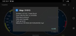

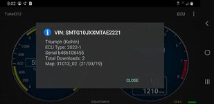

I took the opportunity with my newly licensed copy of TuneECU, and my OBDLink MX+ to attempt to program my '21 Triumph Rocket 3 GT. After connecting to the bike, it appears to me as if the bike might have already been updated by the previous owner. I'm just guessing here, but when I pull the ECU info, the following is displayed in the two attached screenshots. I purchased this bike used with 707 miles on it. I'm unsure how long the previous owner had it but did put on a few K's worth of options and the price was right. Anyhow, any feedback would be welcome here. Thanks. As I stated It appears that this person may have already programmed the bike with the 31003 map. Please note that at this time of the screenshot I didn't even have the map downloaded yet.
Both the stock and Penner maps will show 31013_2 (version 2). You can’t read the map from the ECU so you can’t tell if Penner’s map is loaded.
Great, thanks for the update regarding that. I'm new to TuneECU, so I'm not quite sure what it's showing me. Appreciate the update.
Yes I have the file downloaded and saved to the phone. One curiosity that I noticed is that TuneECU through the MX+ adapter doesn’t seem to want to read the ECU unless I start it. After the bike is started it reads the ECU just fine. After than I just shut it off and leave it in “ON” mode with the display lit. I’m guessing this is normal?
