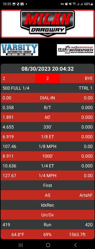

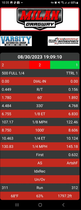

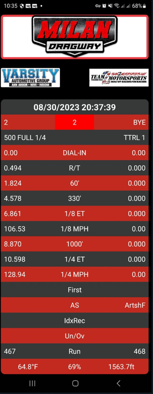

I went to dragstrip again yesterday, I couldnt make past 10.4s. I think I must strap front shocks and make rear shocks tight as much as possible.
I removed mirrors before doing runs,
I reduced rear tire gradually to finally 25psi
i reduced the weight below the seat
I was doing constantly 10.5, 10.6 and so on, best was 10.45, check the photos
Where can I get the straps and which ones are the best, how to put on rocket?
How do I setup rear shock so that it becomes harder?
Thankyou
Looks like first pass was the best, all were fairly close, try some way to cool temps. down between rounds, (engine and gas). In tune ecu, can you lower temp. when fan comes on, on new rockets? Good advice, get as tight and low as possible. Might try at home to make bike stand up solid and practice several positions to get comfortable, if not comfortable you will never improve. As far as rear shock, wonder if being tight is best way to go, would think transfer would be better. Keep working and improving is only way to get there. Good luck.
At the Milan dragstrip there is always 40-50min wait until next run so i think the bike gets cooled down enough between runs?
