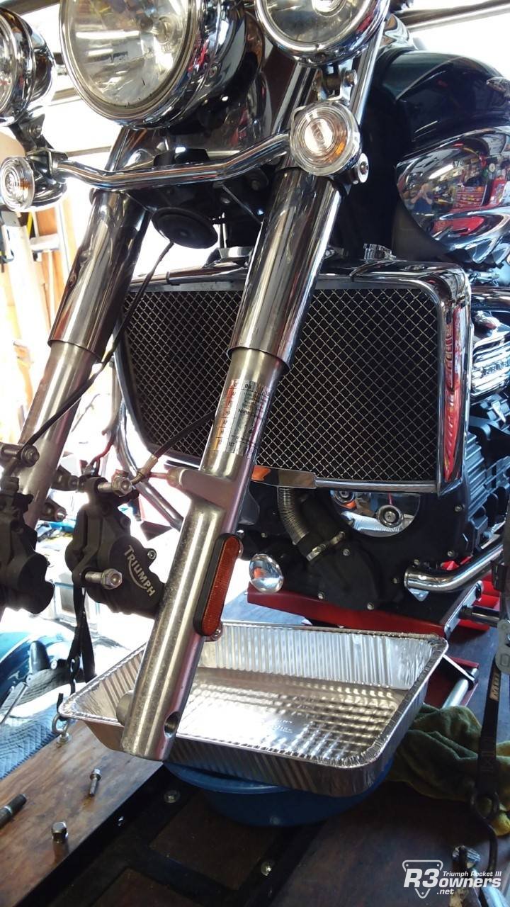

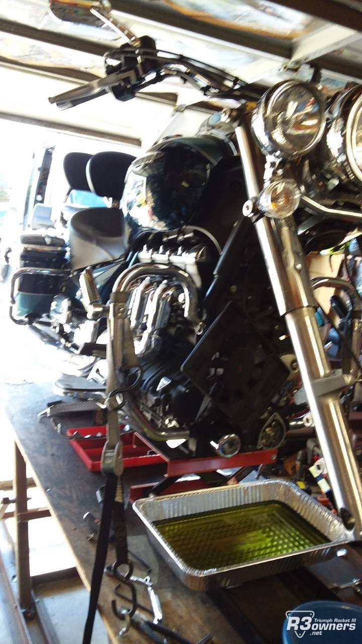

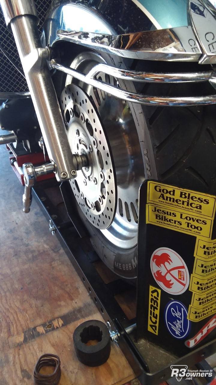

First I lifted my bike and removed the front wheel and fender.

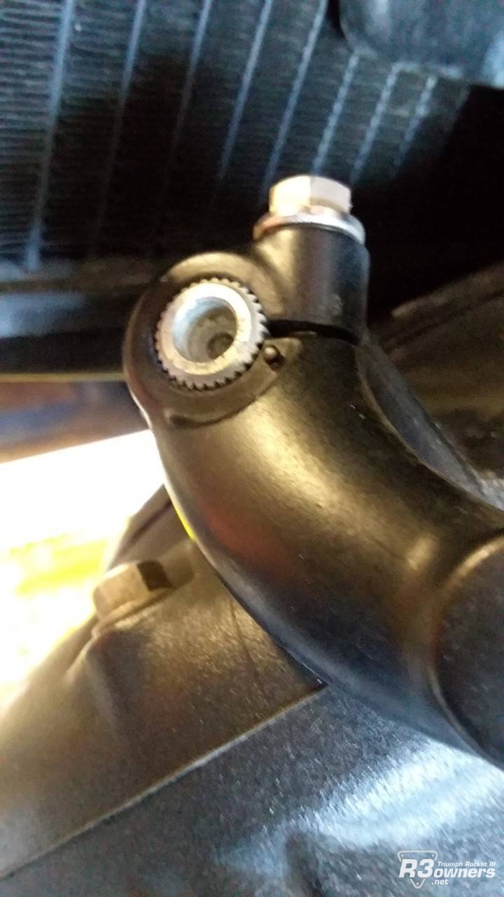

I noted the position of the clutch arm so I could reinstall it in the same place but ended up leaving the arm in place and just removed the clutch cable from the arm.

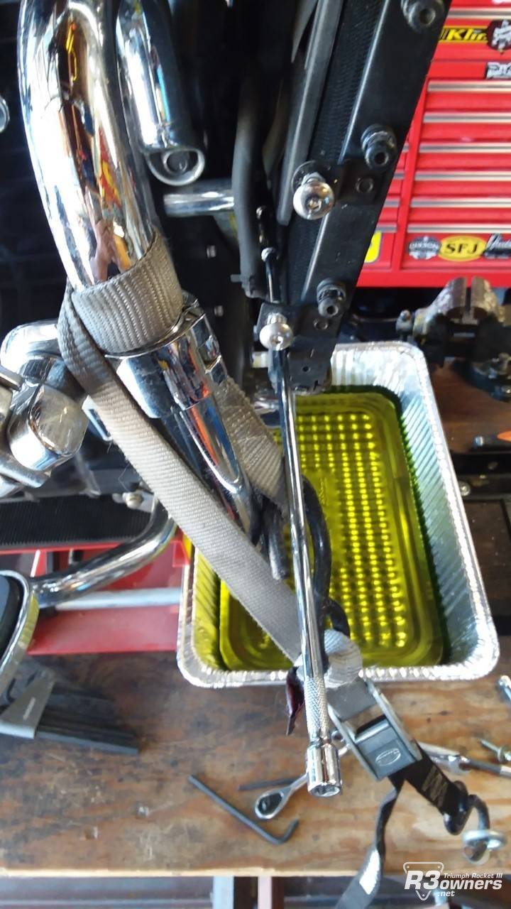

Then I drained the coolant by removing the water pump cover and lower radiator hose.
After removing the radiator trim pieces (“embellishers” makes them sound so much more elegant) I used a couple of ratchet extensions to be able to reach and remove the lower radiator mounting bracket.

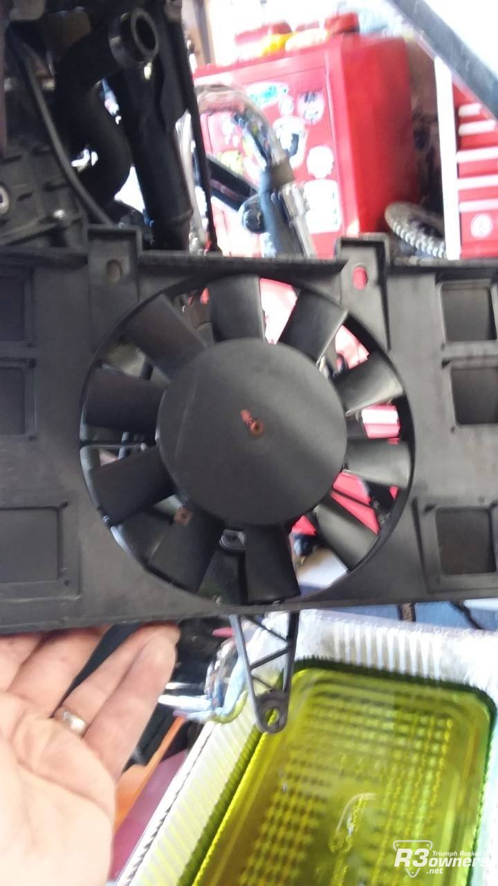

Most of the instructions will tell you to lift the tank and disconnect the radiator fan electrical connection so you can remove the radiator and fan as a unit but instead I removed the fan from the radiator because it seemed easier to remove the three bolts to free it from the radiator than to lift the tank.
I just draped the fan and it’s connecting wires over the crash bar.

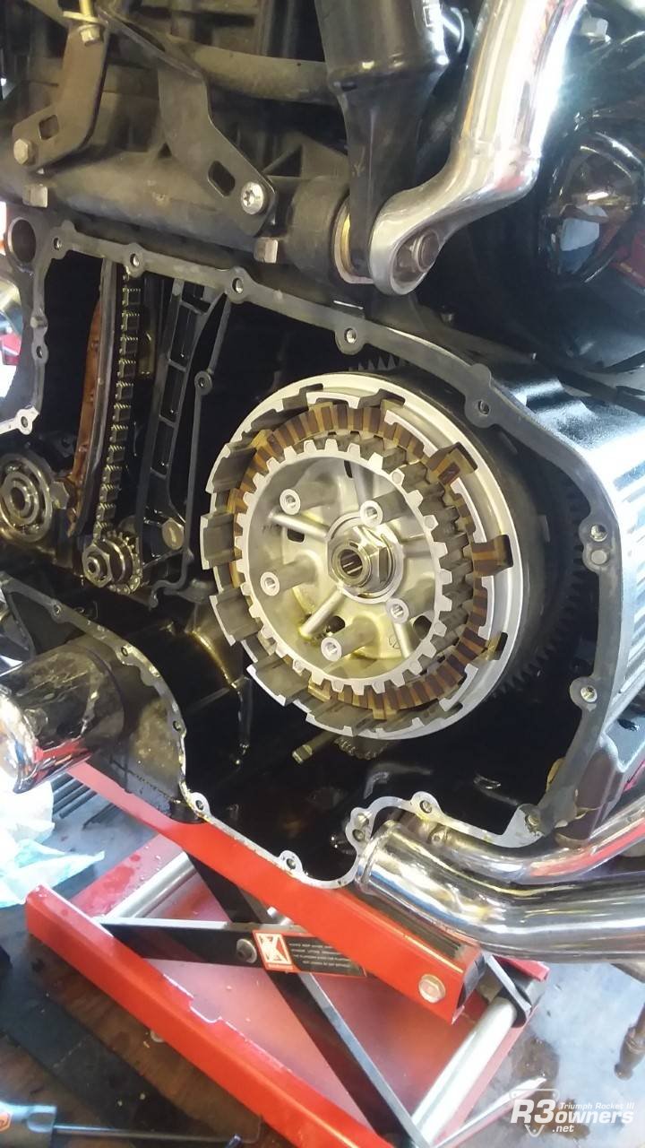

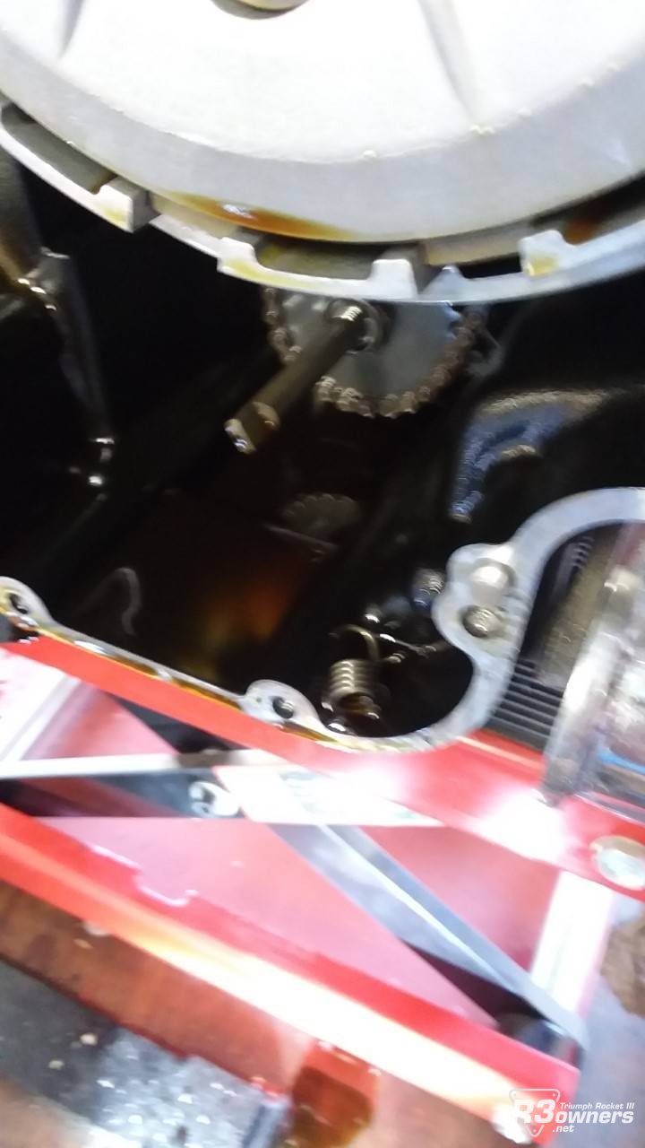

Once the front cover is exposed I removed all 289 bolts that hold it on (it may not be quite that many) and gently pried off the front engine cover to expose the inner workings. If you look carefully you can see the broken remains of the detent spring lying on the bottom of the engine case.

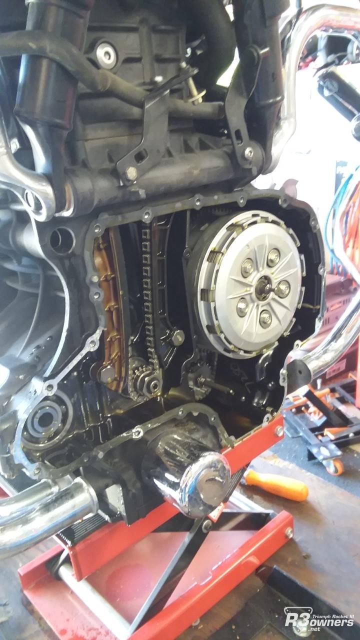

Here’s a closer pic.

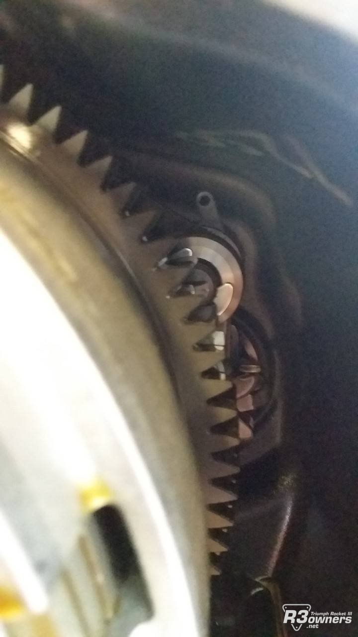

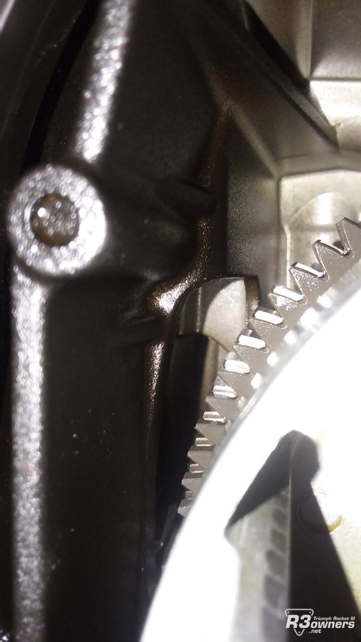

The spring is supposed to be attached to this small arm with the hole in it that is behind the clutch.

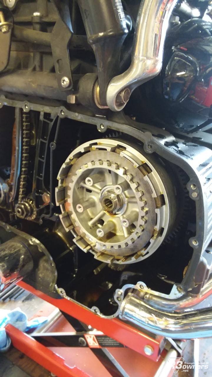

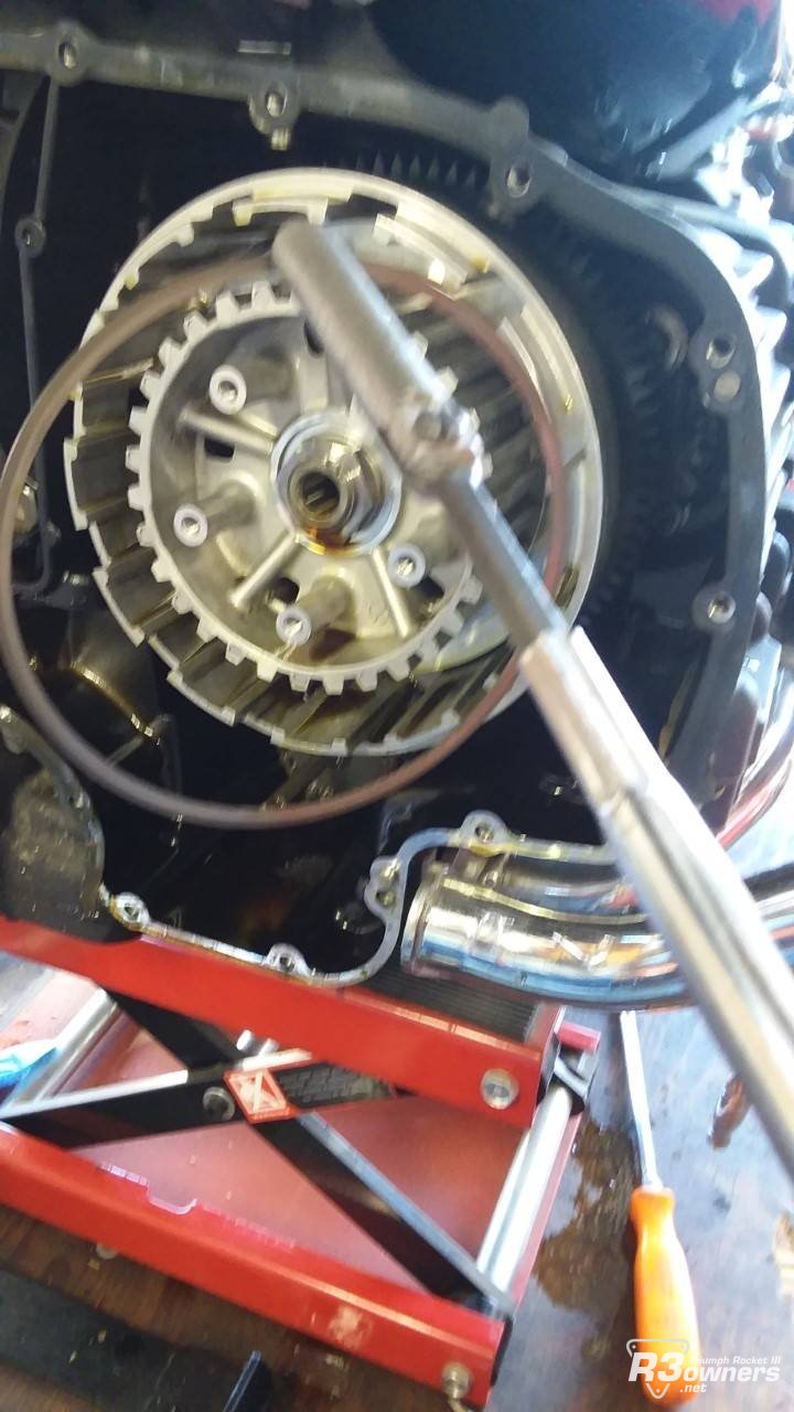

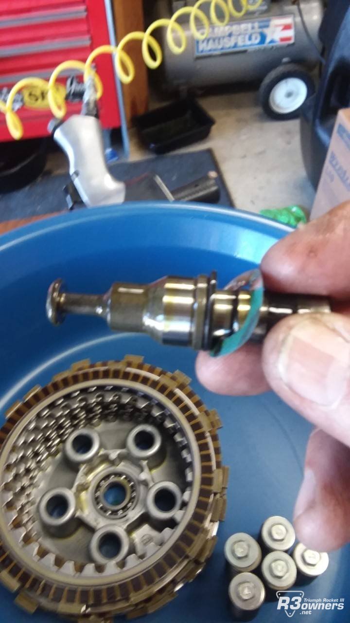

I removed the 5 bolts that hold the clutch hat and then removed the steel and fiber disks making sure that I could reinstall them in the exact order and orientation as they came out.
A video I watched about clutch removal mentioned that the anti judder components were difficult to remove but I didn’t find it to be hard. I just used my magnet tool and it made quick work of it. Two important things to make sure of: First, take note of the orientation of the two anti judder components so they can be reassembled in exactly the same orientation, and most importantly, ensure that you truly have the anti-judder spring, and not the uncle-judder spring! Uncle-judder springs are much more abrupt in their engagement. :)
My clutch actuator seems to be the early design but it showed no abnormal wear or problems of any kind so I did not update it.

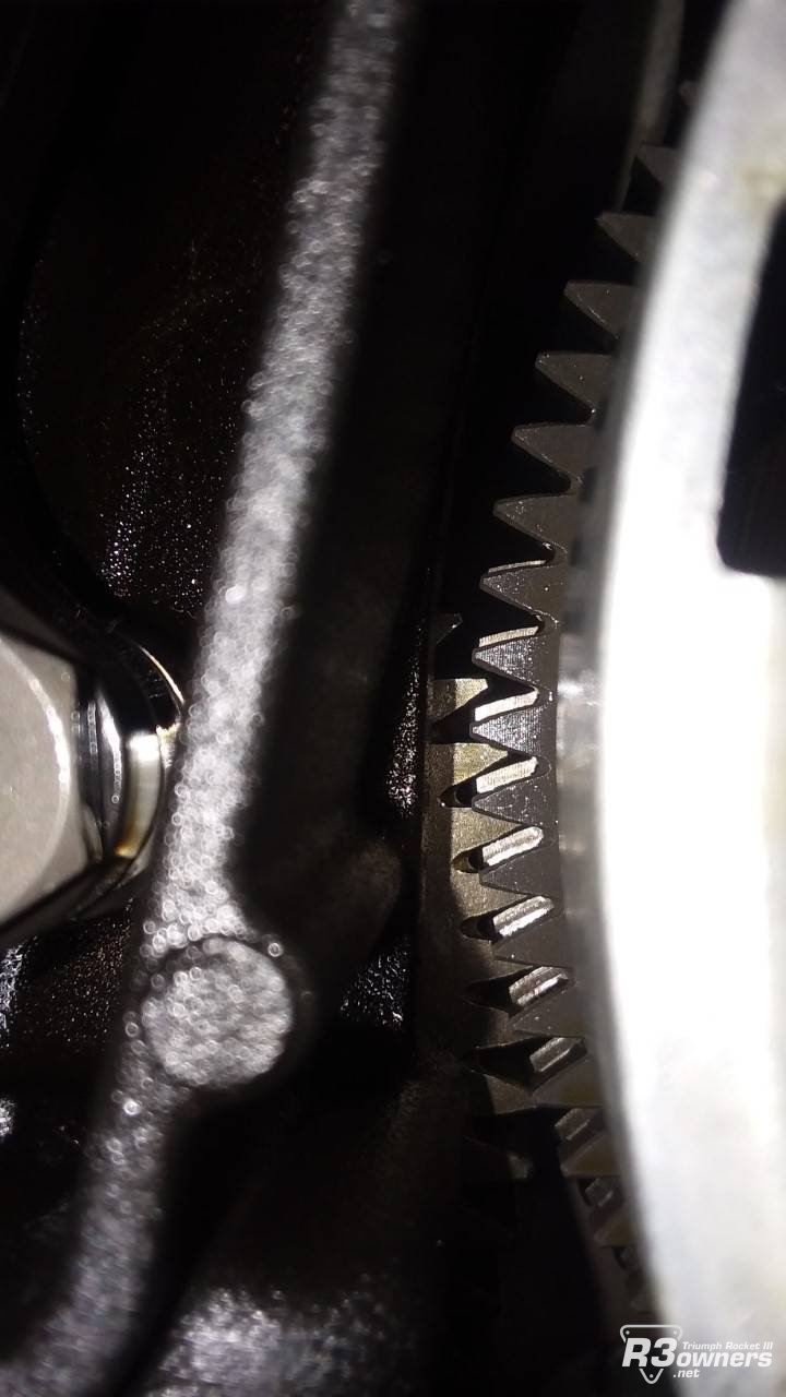

Next is the part that I found to be most problematic of the whole operation. There are TWO separate gears on the clutch hub and they must be aligned to be able to mesh with the teeth on the crank. The clutch hub springs must be compressed for the teeth to be aligned. Some instructions say to use a blade type screwdriver and wedge it into the teeth of the gears to line them up but I wasn’t able to do that successfully. I ended up using the hole and slot that are in the clutch basket. Two smaller screwdrivers positioned correctly can compress the hub springs and align the teeth so they can mesh completely with the crank gear teeth. Next you need to engage the oil pump drive dogs into the recesses in the back of the clutch hub. I did this by using a pair of pliers to rotate the water pump drive shaft which is connected by chain to the oil pump drive. While turning the shaft and applying slight pressure to the clutch you will feel the clutch slide into the dogs.
Then it’s just a matter of replacing the clutch disks and reassembling everything in reverse order.

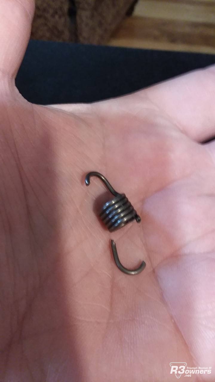

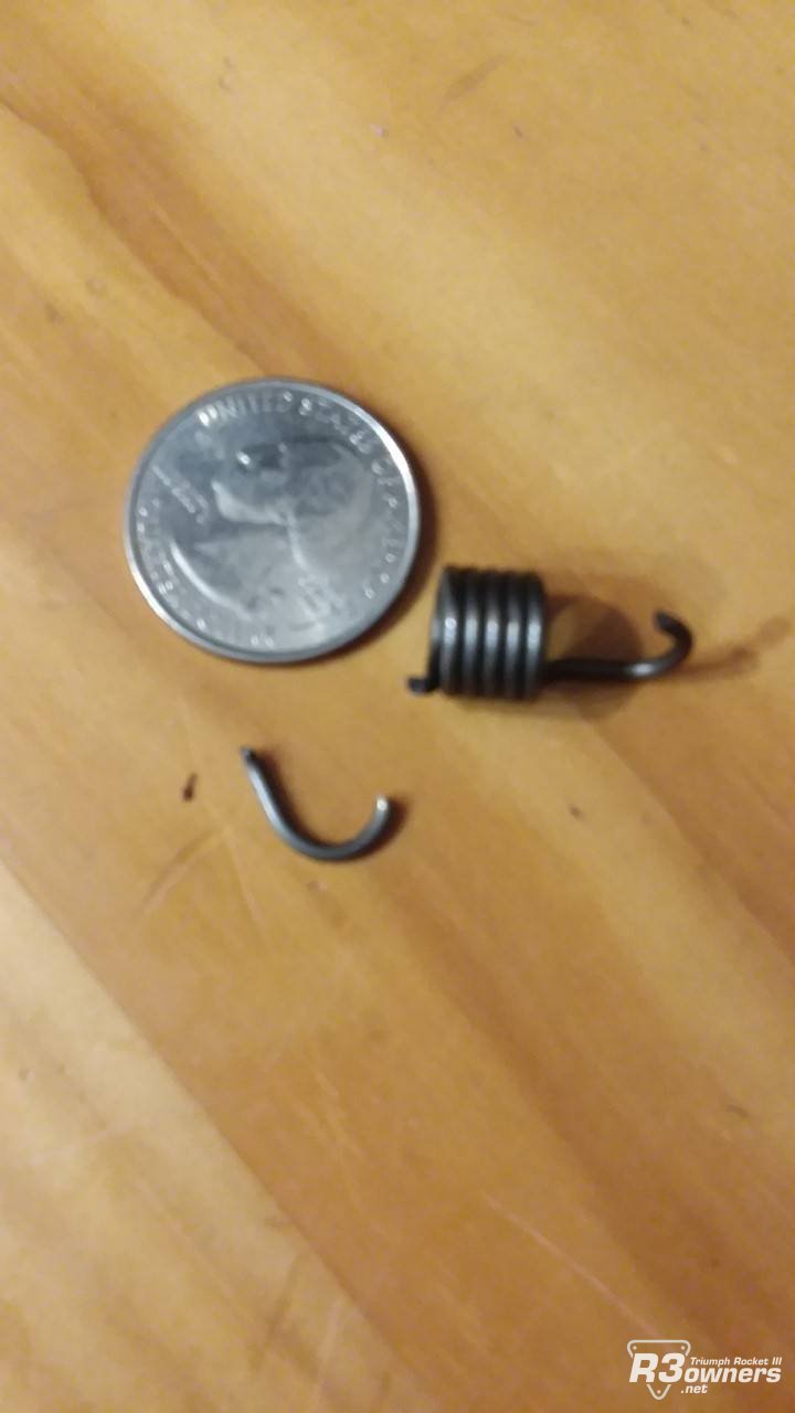

Here is the culprit. I think it cost 6 US dollars!
I noted above that I initially wanted to have the Triumph dealership do the repair. Here’s why I didn’t. I called and spoke to the service department and asked for an estimated cost of the repair. Their response? “That’s a pretty big job, that will cost 4 thousand dollars”! ! ! So this is a four thousand dollar spring!
The results are immediate and very satisfying as the bike shifts solidly and remains in gear. Also, neutral is now much easier to find.
