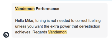

The popping increased after flashing the Penner tune WITH stock exhaust and yes it's the correct one, it's just much louder and noticeable now. The increases in power that Vandemon claims are compared to stock tune and I already have Penner's tune so any additional gains are probably negligible. I asked them before buying about tuning, they said it's not neccessary unless I want the power gains (see attachment) and I just sent a message to Vandemon asking for the tune they used.
