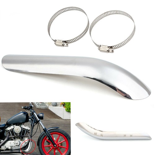

That's what I have too. If you want heat shields look for 10.6" universal heat shields. I got some cheap on EBay.
Or you can get them in chrome
Just my 2 cents, nothing looks better or sounds better on the Rocket Like Carpenters pipe! I just don’t personally care for the spring joints and the adapter plate. If they made them direct bolt up and welded for the same price I’d buy them now!
