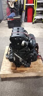

Hello all i recieved the 2015 engine but im a little confused what these two hoses are coming out the front of the block as the 05 block doesnt have em equiped? Thanks

Hello all. So hey i finally got the 2014 engine in and bikes all prepped! One small concern of mine is im not recognizing the hoses coming out the front of the engine? As compared to my old 05 block? Is this a concern? Any advice is appreciated thanks!
