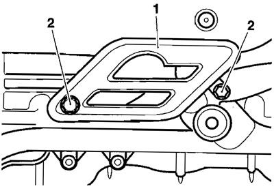

The start of this video is a time lapse of what it takes in broad strokes - but actually the front wheel and fender can be left on.
The manual has a step by step guide on engine removal and refit.
The biggest gotcha is going to be removal of the oil pressure switch at the rear of the cylinder head, before attempting to lift the chassis off.
You can do the job without any lifts etc and by yourself but it will take a lot longer as you'd have to strip the bike completely to make the chassis lift manageable.
I recorded the whole operation in 1st person view the last time round but have yet to edit the vid and post it - seems like it would help a lot of people.
Meanwhile any questions just post up here, there are a good few captains have done it.
I did this procedure with my bike when I was changing the damper shaft bearing.
You can find out how to do this by clicking on the link.
Do not forget to unscrew the oil pressure sensor before removing the frame.
The whole procedure took just over two hours. A friend helped to remove the frame, it was a bit difficult alone.
