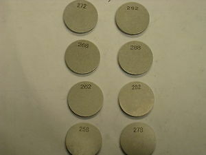

Sets of 1" Japanese Std shims are sold by this guy on eBay he has dozens of sets of different sizes all miked with details of his micrometer and some actual versus stated printed sizes.
I found this text on an expensive shim dealers listings.
See our other listings for various valve shim sizes ranging from 2.50 to 3.10 .... we also have a limited quantity of other rare half sizes as follows: 2.58, 2.62, 2.68, 2.72, 2.78, 2.82, 2.88, and 2.92 ...as you may know, shim sizes are generally only available in .05 size increments (i.e. 2.65, 2.70, 2.75 etc.)
In the past, the only way to obtain in-between sizes was when a bike was brand new, off the press, when the factory sometimes installed shim sizes not normally available at the dealer to provide a perfect valve adjustment on the brand new engine. In most cases, shim sizes in the standard .05 increment range are adequate for performing a high quality valve adjustment within the specified range....but if you're one of those "perfectionists" who want it just right, here's your chance to do so. NOTE: NOT AVAILABLE AT THE DEALER!
Used shims sometimes available from other sellers can be quite a ways off the actual size stated on the shim if you can even read it!
So if you consider ALL of that on this other bloke's offerings.
27 sets listed of different sizes and numbers of shims with duplicates available too.
Lots of these are measured at the supposedly hard to find mid sizes much much cheaper than the first dealers offerings of single shims.
DO NOT BUY THE 1st set you see!
Check you clearances first and buy the smallest set that meets your needs.
READ his detailed descriptions too!

Something that was touched on above, dealers will some times swap shims with customers for a small fee. ALWAYS bring your own micrometer and verify the thickness of the shims to you are buying. Because the cam rides directly on the shim, it is a wear item. Any shim that has been ran in an engine has probably changed size from what is marked on it.
