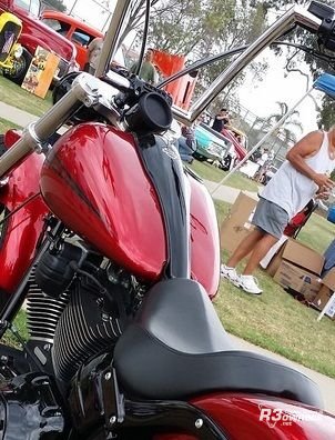

I have been looking at pictures but kind of hard to figure out the differences.. might have to visit a dealer with both types in showroom to compare.. I am thinking of customizing mine and would like a teardrop tank.. already have fiberglass small front fender and short rear fender.
My guess would be some modification on the front attachment might be needed but the back looks similar. Anyhow would have to also modify the top to cover up where the bracket for the gauges sits.. so modifications are already needed..

If the tank will fit with minor modification and match the intakes on the left side then I was thinking of dealing with the indent in similar ways as some of the Harleys who have console without any instrumentation.. like the Breakout

I havent started the fitting yet but at the moment am planning to remove the attachments for the console and fill up the indent on top of the tank and then just keep the original speedo and Rev as is.. I will post some pics when start on this project..
