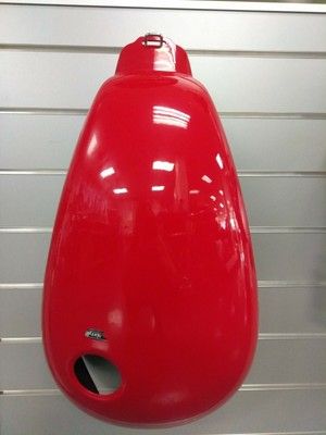

I see some conflicting reports about swapping tanks with a Touring model - I have just tried one on my 2005 and it looks like it might fit.
A bit more research and it appears that this might be from a later Roadster circa 2016ish - a little smaller and with a different kind of fuel level sensor, otherwise exactly the kind of shape I am looking for my custom build (apart from the dents)
