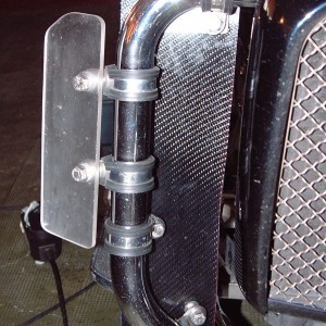

what do you guys think about blocking out the space created when you install engine roll bars and the engine itself, those would be like "lower lowers" :D
Will NOT affect buffeting. May however held stop trousers flapping. And will keep feet dry.
have sinced changed the design to aim air at the engine.
